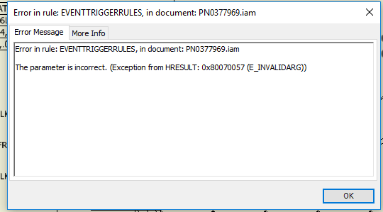

I attached my entire assembly, this way you can actually look at the code for yourself. The issue is with the code in the "EVENTTRIGGERRULE". There are two separate actions happening, the first code is triggered when either "sewn" or "formed" is selected in the form. Then It will determine which parts are active and set them either to Phantom or Normal based on whether sewn or formed was chosen. The issue is that it does not always update correctly and I have checked the code but it looked all right.
The second part of the code is triggered by the inputs of "Collar1" and "Collar2" in the form, this is a numerical input. Based of the inputs it will choose the correct clamp to use based on the input size and if it is over 12" then It will determine the quantity of clamps based on the Variable parameters. Anything under 12" uses 1 clamp.  So the issue is that the BOM will not update the quantities when the clamp is over 12". I tried using event triggers but It is still having issues.
I would really appreciate some help because I have tried everything I could think of.

I'm getting an error on this line of code:
ThisBOM.OverrideQuantity("Model Data","11000138", 2)
 Not sure why yet, the error message isn't very helpful
The parameter is incorrect. (Exception from HRESULT: 0x80070057 (E_INVALIDARG))

I found that if I separate the component.active code from the this.bom code into separate IF Statements it does a better job at updating the BOM quantities.

Message 5 of 12
cameron.frederiksen
That code is working good so far, but now I'm getting this error when I save my drawing.
Message 6 of 12

Message 11 of 12
cameron.frederiksen
I'm getting this error when I save my drawing now. I get it around 20 times, I have to keep clicking ok till it stops.
Message 12 of 12
MechMachineMan
Debug and find out what is making it error.
In iLogic, you can do this by placing
MsgBox("Made it to here 1")
or something similar within the code to see the last line that runs before it fails.
