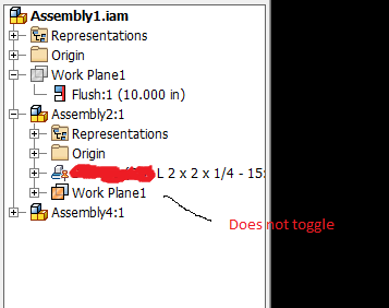

david_campbell
working with your sample 1
user defined planes are not switching.
if I make a offset plane from orgin plane xy when I run sample 1 the plane I created is unaffected by this rule.
Inventor 2013

However when I open Assembly 2 the plane appears to be toggling correctly. It just appears not to reflect correctly up to assembly1.
How do I fix?

Curtis_Waguespack
Hi Diswill,
I think what you're seeing is an issue with view reps in the sub assembly.  Basically, we'll need to have a few lines of code check the component to see if it's an assembly file, and then use or create a view rep in the sub assembly.
To test this theory you can create a view rep in your sub assembly and ensure that your sub assembly is placed using that view rep, and then I think you'll see that the rule works as expected.
I'll post back if I have time to look into the needed code update later.
I hope this helps.
Curtis
Message 13 of 40
david_campbell
your assumption about the view representation appears to be correct.
for us assemblies are normally places with the master view representation.
Your assistance is greatly appreciated.
Inventor 2013
