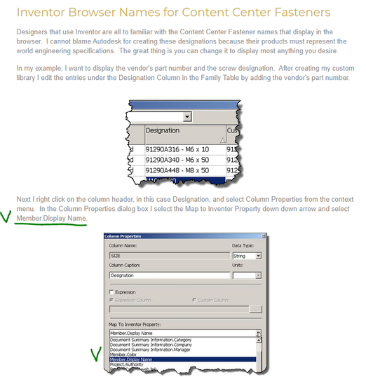

How To Set "Member.Display Name" Via Coding Vb.net or Vba
bradeneuropeArthur
How can I set the "Member.Display Name" for Content Center Fmilies Via Coding Vb.net or Vba
