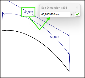

How to edit dimensional constrain with the Inventor Dialog showing
bradeneuropeArthur
How can I edit a dimensional constrain with the Inventor Dialog showing, as in the picture.

Hi Arthur.  This is just an educated guess, but that looks a lot like a 'MiniToolbar', which we can create with the CommandManager.CreateMiniToolbar method.  If you look into the VBA sample the online help page links to, you can see that these can be pretty dynamic, if you want to put that much effort into them.  I have only used them for very basic purposes myself, so far, but plan on utilizing them more in the future, due to how convenient they can be.  The text box control within it could likely show the DimensionConstraint.Parameter.Expression value, for editing that directly.  But I'm not sure it would behave exactly the same, due to how we can actually assign or change the names of the parameters involved through those 'normal' mini dialogs.  How to add that little fly-out control as the right edge of the text box control, I'm not sure about at the moment.

I was interested in this, so I went ahead and explored into it myself a bit.  I will attach the code I have put together so far, but it is not finished yet.  The resulting dialog does not look exactly like the one expected yet either, but maybe there is still a way to change that.  It may simply not a MiniToolbar, but a custom Windows Form or something similar to that.  It's not working exactly as planned yet either, but not causing any major problem when used right now either.  But the edits do not take immediate effect, or not the expected immediate effect yet.  Needs some update or rebuild type something included at the events.  I did put some exploratory stuff into it also, in an attempt to figure out what is going on.  Seems there are already 6 default controls in it, but two are unknown type.

Hi, you want to show this dialog ?
thisapplication.CommandManager.ControlDefinitions("AppDimensionEditCmd").execute

No that is not what I need. When I create a new dimension I want to edit this afterwards.

But it does not allow me to pick/select a ArcLengthDimensionalConstrain.
Do you have any idea..

Hi Arthur.  I had not noticed that before, because I pretty much never use that specific type of dimension, but I do see it this morning.  This is certainly very odd, and seems like it might be a bug.  I have tried most of the filter settings within the SelectionFilterEnum, including the original "kSketchDimConstraintFilter", which does lets me select other sketch dimension types, but not that type, for some reason.  Also tried the most generic of them all "kAllEntitiesFilter", which still will not allow me to select it.  I am still using Inventor Pro 2024.3.3 at the moment, but I am not sure if this is a 'version' specific issue or not.  This should likely be brought to the attention of someone at Autodesk, like maybe @MjDeck.  If anyone can confirm, deny, or explain this situation, it is likely him.  And if not, he will most likely be able to inform the rest of the team at Autodesk about this situation, so that it can get it fixed.
The first thing that came to mind though, when I first read your question, was the line of code at around Line 39, and the other line where that is being used (Line 68)...the ValueUnitsTypeEnum, which threw me off at first, because I am used to working with either of the other two very similar sounding ones (ValueTypeEnum & UnitsTypeEnum).  I did not get the chance to figure out a reliable way to determine the proper value of that Enum from the selected DimensionConstraint or its Parameter, so that I could dynamically set the proper value for it in Line 68 (where it is creating the 'MiniToolbarValueEditor' control).  But it would not be logical for that one setting within the Class block of code to cause the 'Pick' function outside of that area to not work properly.  In the short term, we may have to use a custom 'Picker' type Class (using the InteractionEventsSelectEvents, & OnSelect Event), instead of the simple Pick function, and instead of relying on the SelectionFilterEnum, we can use the ObjectTypeEnum, or TypeOf operator or TypeName function in a custom block of code within the OnSelect event handler, to do the selection filtering for you.  If that would be possible, or worth while in this situation.
Mike may even know of a better way to achieve what you are trying to do here than us.  I've got some other stuff to catch up on at work this morning, but will undoubtedly be thinking about this interesting challenge while doing so.

I have tried the same steps also and I am on Inventor 2025!
