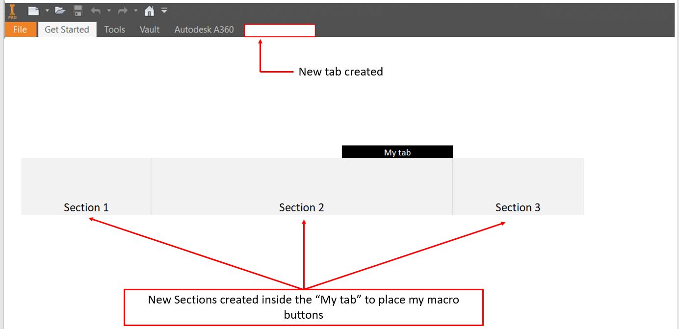

            Hello Inventor experts!
            After some time without post any new doubts, I am here again to ask for your help.
            In this time my target is to create a custom tab where I can put my macro buttons.
            I already have created some buttons using the customize functionality, but is not exactly what I need.
            I have attached an image to help to understand my case.
            I am available to provide any other information necessary.
            I am using Inventor Professional 2020.
            Thanks in advance.
