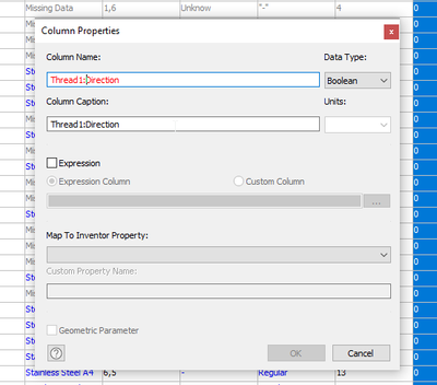

how does I make an Nut with Links Thread in Content Center? We have our own custom write/read library. I don´t want to Cheat or make 2 family´s
My current setup looks like this. But all will be create as normal thread. or Fine Thread , but so far I have not find a why to make Links thread (Thread with left directioin). How do I do it ?

Add this column to your Family:

It don't seems to work. How do I get it to select Links thread(left thread)?
I can´t create it as suggested
