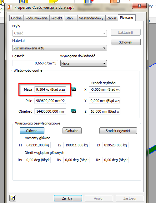

maciej0202g
Good morning.
Point A - they work 👍
Point B - I have made only a drop-down list, is it possible to choose the type of material here
Point C - an example element weighs 9.5 kilograms, is it possible to move the comma
