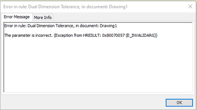

I have many existing drawings that would take a long time to recreate and manually switch the primary and secondary units of the dual dimension style that I'm using. I need help with creating a iLogic rule to give the user the option to toggle the dual dimensioning units. I have a form that asks the user which units (imperial or metric) and would like this to control the primary unit while the secondary unit is the latter.
Any suggested codes?

austin.massey6W6WX
We added those lines into our code
Then we got an error; Not sure what this error refers to.
If we remove Line 1 we get these errors.
Could you walk through what each step is doing?
Is this a VB code? The last line shown was how we were able to get the value of our User Parameter (before adding you code up top). I don’t understand the significance between how your code functions and mine?

austin.massey6W6WX
@Andrii_Humeniuk that did the trick. I initially got an error at "Failed to get DimensionStyle", "Error 3!" and we realized it was due to spacing in "Default-in[mm] (ANSI)".
I changed it to "Default - in [mm] (ANSI)" and the code worked perfectly.
Thank you for the support!
