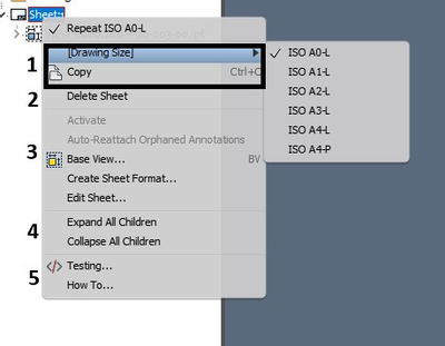

Dears,
I'm trying to adding some popup button instead button on Tab Ribbon.
Something looks like that: [Drawing Size]
- It's helped in this post: https://forums.autodesk.com/t5/inventor-programming-ilogic/right-click-pop-out-button-inventor-add-i...
But I don't know how to add it in another area (2; 3; 4; 5....)
I also wanna add right click popup menu when right click the file in Model Browser like this:
Please help me some resource that relative to it.
Thanks! Have a nice weekend!

What buttons do you want to show than?

Do you need it look like this:
See mp4

Hi @bradeneuropeArthur
Yes, correct! Is there any resources for its?
bradeneuropeArthur
I will share dll and and in file later today.
