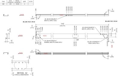

Trying to collect hole centers from 2 drawing views  and add an ordinate set either up or down based on location of holes on view.
this is an example of what I'm attempting to setup
