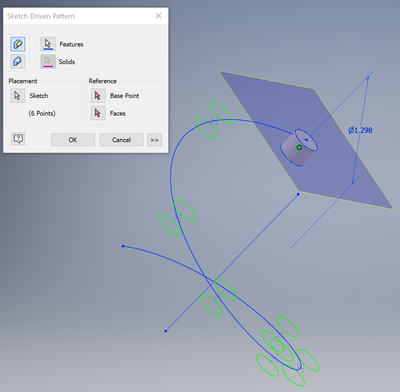

Hi to everyone,
I would like to know if anyone can help to solve my problem.
I'm doing a component that can be done in two ways, one like is show on image 1 and 2, and another one in a helix mode.
So my problem is to create a pattern cut aroud a helix component.
Thanks for the time.

Hello PamLago,
Would you please try whether this function meets your requirement?
https://help.autodesk.com/view/INVNTOR/2018/ENU/?guid=GUID-9B3D1B72-340A-4F3E-9AD1-80E6DDD91ED2
Sketch Driven Pattern allows you to create pattern on the sketch points along a path which is specified in sketch 2d or sketch 3d.
