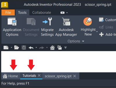

I'd like to know whether it possible (and how if 'yes') to detect/handle activation of non-document tab ('Home' or 'Tutorials')?

Seems like I need to handle the UserInterfaceEvents.OnEnvironmentChange Event
I've tried the VB.Net code:
Private Sub UiEvents_OnEnvironmentChange(Environment As Environment, EnvironmentState As EnvironmentStateEnum, BeforeOrAfter As EventTimingEnum, Context As NameValueMap, HandlingCode As HandlingCodeEnum) Handles UiEvents.OnEnvironmentChange
      MessageBox.Show("!!!")
End Sub
(this is just copy-paste from the help)
But Visual Studio (2022 Community) refuses to compile it with Error BC31029
Method 'UiEvents_OnEnvironmentChange' cannot handle event 'OnEnvironmentChange' because they do not have a compatible signature.
What I'm missing?

Actually, what are you trying to do?
Prevent Home and Tutorial from running?
An addin/iLogic can turn off the commands.
Tutorial is addin you can turn off.
Close them when the tabs are there?

I'm developing the AddIns that has a widget which is supposed to be hidden as soon as  Graphics Window stops showing any document.

Found it, ByRef:
Private Sub UiEvents_OnEnvironmentChange(Environment As Environment, EnvironmentState As EnvironmentStateEnum, BeforeOrAfter As EventTimingEnum, Context As NameValueMap, ByRef HandlingCode As HandlingCodeEnum) Handles UiEvents.OnEnvironmentChange
End Sub
Maxim-CADman77
Yeh, I should have notice the HandlingCode argument is 'Output'. Thank you!
Now the code compiles, but for some reason I can't get the Sub to run (even so EventWatcher* catches the event on switching from document tab to Home or Tutorials and on opposite switch):
Again I'm missing something.
UPDATE:
Another necessary line was for some reason absent in my project:
UiEvents = invApp.UserInterfaceManager.UserInterfaceEvents()
