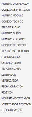

I want to extract almost every attribute within the block, the identifiers being as this photo:
I don't need the ones in red.
I just asked for extracting one so I could copy paste the code several times, and you didn't have to make every line.
-It may also be important for us to know how many attributes are in that block.
They are 26, being the ones in the photo the first 22

The same thing as before is for the custom iproperties, I asked for one, so I could copy paste ir an do it several times.
The iproperties are as follows:

the iproperty does exist but has been emptyed so just hit apply or accept and whe have it.
Again, not sure how difficult is to achieve this in ilogic
