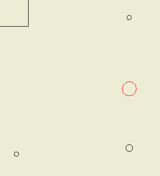

Hi all,
I've got iLogic code working such that I can loop through all the holes in my idw. I was wondering if there was a way to find the feature name of a specific hole in a drawing.
For example: This hole would tell you its part of the "Hole3" feature
Any help would be appreciated

I am trying to change the IsEqual function with matching a feature name instead
JhoelForshav
Hi @MichaelLockhart3046
I don't know if you want the code to write the feature name in the holes or if you just want to compare the feature name to a string with your IsEqual-function. I've edited the code for both scenarios.
Write name of feature in hole:

I hope one of them is what youre looking for 🙂
MichaelLockhart3046
This is exactly what I needed! Works amazing, thanks
