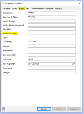

FINET_Laurent
Hi, The same way I suppose.. :
"Project" , "Revision number"
Regards,
FINET L.
