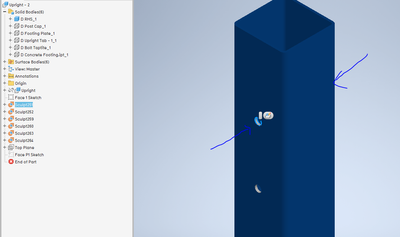

Hello All,
I thought this was an easy step but after 5 hours of looking through the forum and the Net its not that straight forward it seems.
I create a sketch on a plane and the project feature edges to it.
I just need to find the edges that are closer to my plane since it projects all features.
The Code can identify the faces then the edges but I cant get a location of that edge because its a feature surface body edge?
I tried Face.geometry to attempt at getting the geometry of the surface body face.
Any ideas to avoid the back surface body feature to not be included on my face sketch?

cencinaNB2ET
I Manged to come up with a workaround...
basically placing a point in the middle of the edge loop and then measuring to the face/plane to see if its the correct one or not.
Although Im getting the opposite loop maybe someone can fix this?
But its working for now...

WCrihfield
Is the main part a solid or surface body? Is your sketch plane on the face of the part?  Is your sketch plane offset from the face of the part?  Why use sculpt instead of hole command or extrude circle sketch? Can you provide un-confidential file to experiment on?
Wesley Crihfield
(Not an Autodesk Employee)
cencinaNB2ET
Its a solid with embedded surface bodies from sculpting.
Those holes were created from an assembly where multiple parts interact and change position. So I wrote a code that makes those holes by sculpting. All the parts in that assembly are derived so the workflow will be too hard to create holes or extrusions since its all connected. The sketch is made on a Workplane on the face of that part. Again that part is derived so need to avoid post creation of work planes etc.. as it unliks and links to ita parent assembly all the time. Hard to explain but trust me, tracking extrusions or Hole features will tenfold the complexity in this case.
cencinaNB2ET
I'll post a file with the code that needs to run tomorrow. Remember it needs to iterate any given number of surfaces bodies on any given face. Determine which surface body cuts through what face and then collect those edges to project the circle entity onto a sketch that creates parameters measures the distance and then saves it all as userparameters.
