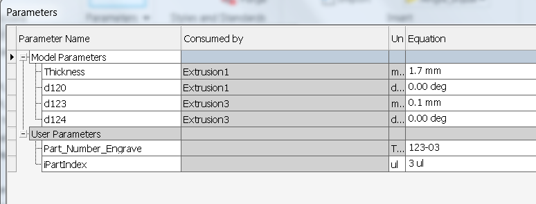

Curtis_Waguespack
Hi @mahleauto
I'm not sure that there isn't a better way to do this, but  what I have done it the past is to add a numeric "index" parameter and include that in the ipart table, then you can have the iLogic rule "watch" the index parameter and set the engraved text as needed.
Also, just as a reminder there is the Inventor Customization forum for programming and ilogic questions of this type:
http://forums.autodesk.com/t5/Autodesk-Inventor-Customization/bd-p/120
I've asked the moderators to move this thread to that forum for you.
'watch this parameter so when iPart member changes
'the rule is triggered
oTrigger = iPartIndex
'set the engrave text parameter to be the part number
parameter("Part_Number_Engrave") = iProperties.Value("Project", "Part Number")
'update the part
InventorVb.DocumentUpdate()
I hope this helps.

I don't do much in the way of combining ilogic and iparts, but I think most of the ilogic snippets are intended to work at the assembly level, acting on the iPart factory(parent file) to swap out members, etc... vs working at the part level to setup or configure the factory file.
I think that is the case with the lines you are trying to use... meaning I think those are meant to be used from an assembly file, and are expecting a component occurrence name.
