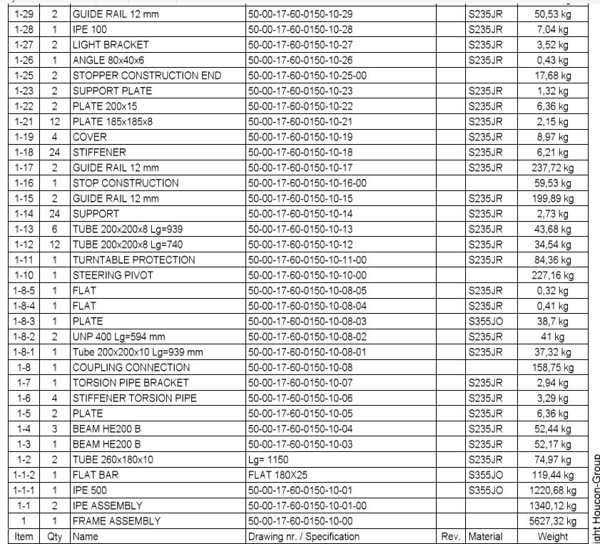

for a dead weight calculation, i want to export the main assembly partlist to excel. This main assembly consists of several subassemblies. When exporting to excel i want to have the following structure:
1 - subassembly 1   -   2000 kg
2 - subassembly 2  -  1200 kg
etc......
then these subassemblies need to be converted to seperate list , like :
subassembly 1
1 - part1   -   200 kg
2- part2  - 100 kg
3 - subassembly 4 - 75 kg
etc...
the problem is to get the subassembly 4 in a seperate list again.
i think i have to write some sort of recursive routine.
Somebody got a solution for this.?
Thnx!!!
Greetz Chris

Are you talking about the Partslist or about the Bill of Material?

it's about the partlist....
Chris
bradeneuropeArthur
Could you upload your code so we can modify it?

ultimateconjoe
It's little bit of messy code, but it's doable...:)

ultimateconjoe
Ok,
i will put it in another way then.....Smiley Happy
I want to convert this partlist  :
into this , with vb.net :
So if an item in the main assembly consists of a subassembly, it has to been written in a seperate row..... and so on...!
I hope someone can help me...!
Thnx!
Geertz Chris
