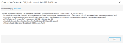

I have the follow iLogic rule to prompt for a DXF export when saving. It ran fine untill I updated to 2022, now I am getting the following error. I'm not familiar with iLogic code, anyone have any ideas?

1,381 Views
Ralf_Krieg
Hello
Is this path already correct?
C:\Users\Farr\Documents\Inventor\DXF_EXPORT_INI\DXF_EXPORT.ini

I changed that path to what's in the following code. It runs now, however it is exporting it into a .ZIP file under the part number, rather than into the directory as all the other files. Any ideas as to why that maybe happening?

Ralf_Krieg
Hello
Check exportdxf.ini for the option set USE TRANSMITTAL=No
