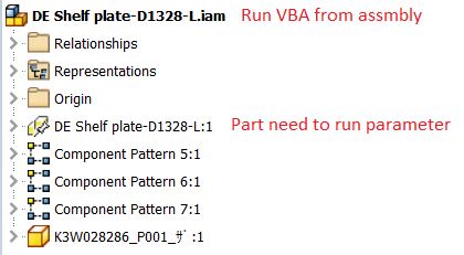

tonythm
Hello Jane Fan,
How to run VBA user parameter of the part component in assembly. Can you hepl me.
I have the code from VBA excel to run into inventor, but not working.
