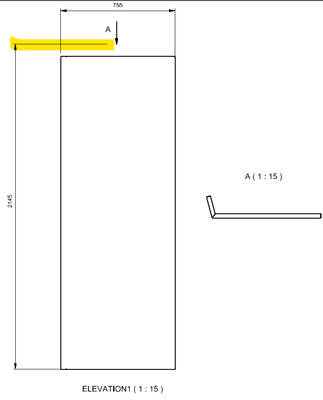

I'm trying to add the horizontal and the vertical extent dimensions to a flat pattern view, but so far  unsuccesfully. I'm pretty sure someone already has code for that... 🙂
I tried several approaches to find the outmost points, but my current approach is to intersect every drawing curve with the view boundary box lines to find the outmost points and create geometry intents on the found curve at the outermost point, to later add dimensions. But the problem is, sometimes the line2d.intersectwithcurve function does not return anything (unless using a huge tolerance, in which case it returns the wrong point) even though the curve does intersect with the line. Also, if the curve is a line parallel to the intersect line, it also doesn't return an intersection - but then how do I know if the lack of an intersection means a: there's indeed no intersection, or b: the two lines are parallel and coincident?
Anyway, some code showing how to do this would be helpful. Thanks!

bshbsh
Hey,
thanks for the reply. But I do not want to dimension sketches - are those associative at all? I do not want any sketches.
But I've made some progress. Now it does occassionally work, but I'm getting kinda unexpected results. I have added some visualisation (purely for testing purposes, these won't be in the code later.) The code now colors which drawing curves it found to have intersection with the view border basically, and also draws a circle where this intersection point is. But when I add the dimension and the intent is on a circular curve, the dimension will be created between the centerpoints, instead of the supplied point type intent. (See screenshot.) Why is taht and how to fix it?

Message 4 of 17
Good job.
May be for some curvy geometries you can use;
Dim oIntent1 As GeometryIntent
    Set oIntent1 = oDrawDoc.ActiveSheet.CreateGeometryIntent(oCurve, PointIntentEnum.kXXX)
    'PointIntentEnum.kTopMiddlePointIntent
    'PointIntentEnum.kLeftMiddlePointIntent
    'PointIntentEnum.kBottomMiddlePointIntent
    'PointIntentEnum.kRightMiddlePointIntent
Message 5 of 17
bshbsh
Awesome, many thanks! I didn't know of this.
Here's the (so far) final code if anyone needs it.

If you look at the image (created by your last code) that is attached to this post.. it is not ok yet, but will be.
May be you must specify four more GeometryIntent and set first group only for linear segments, and second group only for curvy  segments, and check them if they are inside the rectangular extent box.. finaly eliminate some of them and using remaining four intents create horizontal and vertical dimensions. Or try somethng else, but I believe that you will soon find the perfect way that fits all types of flat geometry.

Message 8 of 17
