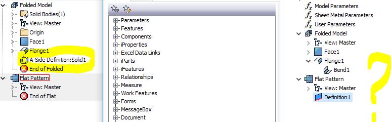

I like to add an A-Side definition if there is none when i save my sheet metal part.
Is there a way te determine if an A-Side already exists with iLogic?

Hello Robert,
with this code (iLogic) you can get the "AsideStatus"
Dim smPart As PartDocument = Thisapplication.ActiveDocument
Dim oSMCompdef As Inventor.SheetMetalComponentDefinition = smPart.ComponentDefinition
MsgBox(oSMCompdef.ASideFaceStatus.ToString)
kASideDefault 106241 The A-Side face is determined by Inventor.
kASideSick 106242 The A-Side face is specified but invalid.
kASideUpToDate 106243 The A-Side face is specified and up-to-date.
(this is from the help)

Hi Herm Jan,
I was so close to it, the MsgBox(oSMCompdef.ASideFaceStatus.ToString gave me the correct answer.
