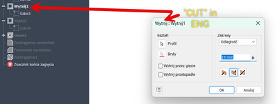

There is no property like Depth for CutFeature Object.
In holes i colect the depth by:
Dim holeDepth As Double = hole.Depth
How to check the depth of Cutfeature ? Could you please present the approach?
My goal is to identify all blind holes in sheet metal, including the ones made by "cut" function,
