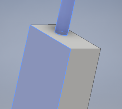

After selecting a cylindrical surface and an edge, I would like to create a workplane tangent to the cylindrical surface and perpendicular to the edge with API.

Could you try AddByPlaneAndTangent method to workaround? It creates a new work plane that is parallel to the input plane and tangent to the input surface.

As the behavior of "Tangent to surface and parallel to plane"in UI, you need select the planar face or another work plane as the reference work plane, but not an edge.
Here is the code. To implement it, please choose cylindrical face first, then choose a planar face:
Sub Test()
Dim oDoc As PartDocument
Set oDoc = ThisApplication.ActiveDocument
Dim oWPs As WorkPlanes
Set oWPs = oDoc.ComponentDefinition.WorkPlanes
Dim oClindFace As Face
Set oClindFace = oDoc.SelectSet(1)
Dim oFace1 As Face
Set oFace1 = oDoc.SelectSet(2)
Dim oWP As WorkPlane
Set oWP = oWPs.AddByPlaneAndTangent(oFace1, oClindFace, ThisApplication.TransientGeometry.CreatePoint(0, 0, 0))
End Sub
