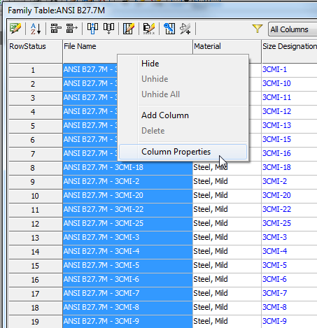

Edit family table and now you are able to change the file naming scheme
Does this workflow help?
