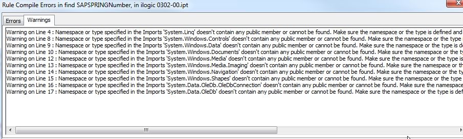

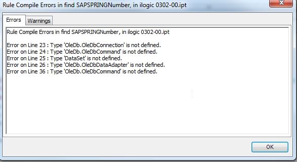

jparks_79
Hi Chandra,
I tried your example and I get the following errors:
Here is the code block I have:

Message 5 of 25
chandra.shekar.g
Autodesk Support
Autodesk Support
Hi @jparks_79,
Try the following changes in iLogic rule.
AddReference "System.Data"
AddReference "System.Core"
Sub Main()
	Dim Connection As System.Data.OleDb.OleDbConnection = New System.Data.OleDb.OleDbConnection("#######")
