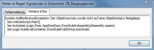

But i have another, hope "little problem", i get this message if i have an assembly shored in.
Hopefully you can help me again....  Thanks in advance.
Very best regards
Martin
Message 9 of 14
JaneFan
Hi Martin,
I see. 🙂
Please change this line:
From:
For Each oDoc As PartDocument In doc.AllReferencedDocuments
To:
For Each oDoc As Document In doc.AllReferencedDocuments
Jane Fan
Inventor/Fusion QA Engineer
