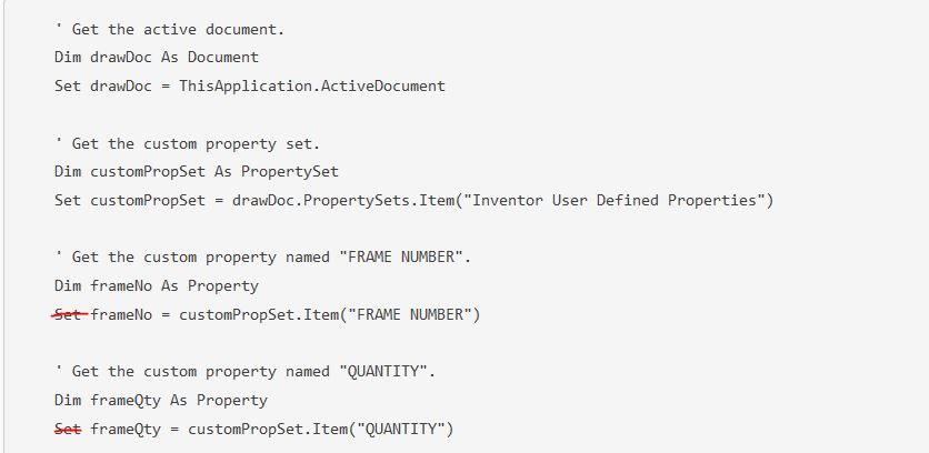

I am trying to access a drawing's custom iproperties using the following code.  When I Debug the customPropSet variable I get nothing, and when I run the complete macro it does not recognize the custom iproperty values.  Am I missing something?
    ' Get the active document.
    Dim drawDoc As Document
    Set drawDoc = ThisApplication.ActiveDocument
    ' Get the custom property set.
    Dim customPropSet As PropertySet
    Set customPropSet = drawDoc.PropertySets.Item("Inventor User Defined Properties")
    ' Get the custom property named "FRAME NUMBER".
    Dim frameNo As Property
    Set frameNo = customPropSet.Item("FRAME NUMBER")
    ' Get the custom property named "QUANTITY".
    Dim frameQty As Property
    Set frameQty = customPropSet.Item("QUANTITY")
Thanks in advance.

ekinsb
I don't see any obvious problems with your code.  Below is a modification where I've created a little function that gets the value of the iProperty and will return an empty string in the case where the iProperty doesn't exist.
Public Sub TestCustomProps()
    Dim frameNo As String
    frameNo = GetProperty(customPropSet, "FRAME NUMBER")
    Dim frameQty As String
    frameQty = GetProperty(customPropSet, "QUANTITY")
End Sub
Public Function GetProperty(PropSet As PropertySet, PropertyName As String) As Variant
    On Error Resume Next
    GetProperty = PropSet.Item(PropertyName).Value
    If Err Then
        GetProperty = ""
    End If
    On Error GoTo 0
End Function

Message 12 of 13
Brian - once again you nailed it.
Thank you very much for your help.
