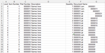

I recently wrote a VBA script to export the BOM of the currently open assembly or drawing in Inventor 2023. This script grabs the currently active file you have open in Inventor, where after goes through all underlying subassemblies and parts. It uses the inventor object library to access your inventor instance. I dont know how to get the images out, but this atleast captures the structure of the BOM
Im sadly not able to share a real example because of my NDA, but ive made an example with placeholder data:
If you'd like to take a look at this, then see the code below:
If you are using vault, it'll ask you to check out all underlying parts. Here the script will still work with simply clicking "No to all" and then not saving the changes made to the files. Be aware of line 160, where i use formulalocal. This is because im working with danish excel function names. If you choose to use this code then remember to change this line to your local language or english excel syntax. (gentag means repeat in english).  This formula will show the assembly in a hierarcal view, just like the browser tree.

This script was written to compare Inventors BOM with our ERP system for data validation. If you are interested in doing something simmilar, ive got a couple more tricks for doing this. 🙂
Hope this helps,
-Anders
