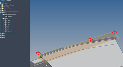

I am trying to place the parts and constraint them based on the excel file that I have created. I will walk you through the workflow to have a better understanding of what I am trying to achieve here.
1. There is an excel file located at a defined path and it has the file name in one column, the rule goes through each of the line in excel and search that file name in a defined directory, upon finding the part it is placing the part in to the active assembly. Now after placing the part in the assembly it records the model name of that part and updates the excel cell values to reflect the model name. refer to the first script.

2. Now the excel has been updated and all the parts have been placed and we have access to the model names for each of them. I want to apply flush or mate constraints based on the defined plane names for example "YZ Plane" I am also attaching the excel file that has been used to help understand the data structure. the origin plane is for the initial trial, I want to use the user planes that are visible in the image.

Note: the parts that I am using are Ipart factory parts, they have been generated and the link has been broken between child parts and the parent part. even though I have included my user planes in Itable  while making these parts so the necessary user planes are present in all the child parts, I cannot access them in the assembly model browser even though they are visible in the image and in the assembly. I do not have that much of the experience so I would not know if this is the reason why it is not working or something else.
I am getting this error while running the second script so I am posting this here to get a solution. Thank you!

A.Acheson
Hi @dparmarF6BDE
Judging by the error message which isn't specific the error occurs in the try catch statement. I would suggest to switch off this try catch statement in order to generate a system message. Look then at the more info tab and see if the message makes sense.
If you further need to debug I  would suggest you go line by line on each object and return a property of the object to ensure it is correct. example would be the name of the workplane. Also ensure you can manually carry out the workplane constraints. This will ensure it is possible to do the operation. For the custom workplanes they should be available in the model tab.
You can also use another method to figure out the path to write the correct code. After  manually constraining use  the capture tool in the ilogic editor to capture the ilogic API code used. This will show if there what construction is needed.
