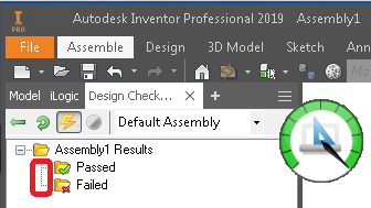

I've just rolled back IDC version from 1.0.9 to 1.0.5 (we are using Inventor 2014) because of failure to show results of custom iLogic checks in Assembly profile on LiveCheck on Document Open  (it just shows two empty folders PASS and FAIL).
1.0.5 version has no this issue.

Same PC with the two Inventor versions installed (2014 and 2019).
1. Install IDC1.0.5
2. Run Inventor 2014 with Default.ipj active
3. Make sure that in IDC settings LiveCheck is Enabled and xml used.
4. Add the attached Sample iLogicVB rule to the «Default Assembly Profile» with Event Trigger = «Open file».
5. Create a new IAM and make sure it’ve passed the custom check:
6. Close Inv2014.
7. Uninstall IDC 1.0.5 and install 1.0.9
8. Start (reregister etc) Inventor 2019 with ipj active
9. Make sure all IDC settings are the same
10. Create New IAM and make sure you don’t know whether the check have been run at all:
11. Re-run all Checks to make sure the issue only happens on Open:

Maxim-CADman77
Huh, forum seems not accept iLogicVB extension for attachement.
Please find it "zipped".
Please vote for Inventor-Idea Text Search within Option Names
Message 27 of 31
YuhanZhang
I can reproduce the problem and logged it as INVGEN-23153, please provide the number to query its status. I will let you know when it is fixed.
