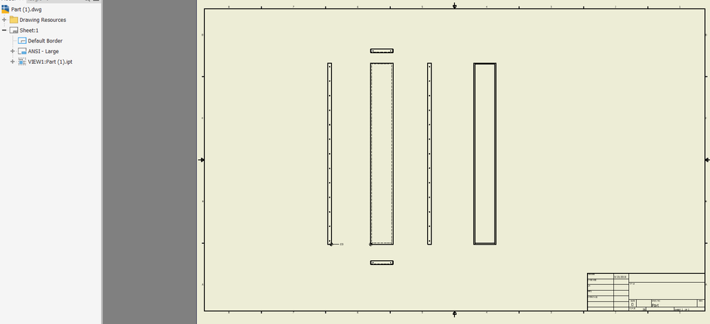

I'm trying to use iLogic or VBA to add ordinate dimensions to a drawing. This picture explains it.help.png
Here is the code I'm working with so far.

Here are the part and drawing documents.
Message 4 of 22
Here is what I have now.

 I keep crashing at this line.
oOD = oODS.Add( kCenterPointIntent, oTextOrigin1, kHorizontalDimensionType)
 I've tried many combinations for theOrdinateDimensions.Add Method.
