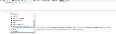

Curtis_Waguespack
@WCrihfield, your last post gave me the idea to just import the iLogic interfaces as shown below with: Imports Autodesk.iLogic.Interfaces
That imports statement connects the renumber extension to ThisDoc as you mentioned, and shows it in the Intellisense.
I think this creates an intuitive experience for the users I was aiming this at.
Internal or External calling rule:
AddVbFile "MyHelperFunctions"
'place the comopoent with no browser name specified
Components.Add("", "BRACKET_00.iam")
Thisdoc.RenumberNamedComponents("BRACKET")
