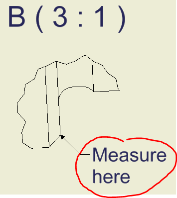

Hi guys,
I want to automate my workflow a little bit and I'd like to insert leader note to my drawings with ilogic rule.
I've managed to insert my note to the drawing like shown on the image below with iLogic rule.
Now I just need to justify the text of the note like shown below (justified manually). I don't know where and how to put justification property.
Thanks in advance for all replies.

Change to this:
    oLeaderNote.HorizontalJustification = 19969
    oLeaderNote.VerticalJustification = 25601
Ilogic cannot use the object as name directly.
use the numbers like above!

Togo
Yes, I have tried that in VBA Macro and it worked.
And with numbers in iLogic it also works now.
I have alse get rid of the error message. It was caused by last line before End sub.
So the working code is:
