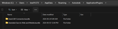

I can't figure out why my new add-ins aren't showing up in the add-in list for Inventor. I get the add-in showing up and saying that it's blocked by default, but then it doesn't show up in the add-in list. Everything that this help document describes, but none of the solutions fix it: (Add-in is missing in the list of blocked add-ins and in the list of add-ins in Inventor)
I think I've checked everything, but because Inventor doesn't list out anything; I'm flying blind.
I've gotten another add-in to work correctly... but even comparing everything to that: there's nothing different in the settings... but it's not working. (Different GUIDs of course)
I have:
Confirmed that I'm publishing to .NET Framework 4.8:
Publishing to the appropriate Add-in folder: C:\ProgramData\Autodesk\Inventor Addins\{addin name}
(Note: I've blanked out the 'build events' so it's not making any duplicates of the build files anywhere)
Running Inventor 2024 as the debugger:
Reviewed the contents of the build:
Reviewed the Addin file:
Reviewed the manifest file:
and I've made sure that only the .manifest and the .addin are being "copied if newer" from VS2022 when I do a new run.
I've even gone so far as to just copy the .addin and the .dll to a different computer. I get the add-in showing up in the "we've blocked this" prompt, but it's STILL not showing up in the add-in list.

@danny.lewisA9QBW , I've had issues with spaces in add-in name or add-in folder name, you might try it with no spaces.

I tried starting a new project with the name 'Point_Cloud_Tools' and that seemed to work, but it still leaves me scratching my head as to why the others won't show up.
hmm... I then had a look at the location and noticed it was coming from the 'user roaming' and was also being copied to the ProgramData location; I thought this would NOT make it work. I then deleted the user/roaming location files and it pointed to the programdata files (just re-running Inventor, not running it through VS2022).
I removed the build functions that created the user/roaming files and ran Inventor through the debugger.... everything seemed to work fine, but I still don't know why my other ones are broken.
So then I tried another project that I had started. It ONLY exists in the ProgramData>Autodesk>Inventor Addins folder; but still won't show up on the add-in list.

jjstr8
In the files you attached, the dll has no underscore but there is one in the .addin file. It showed up for me once the underscore was added to the dll name.
