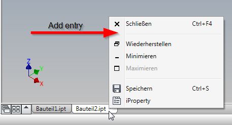

Hello together,
how could I add an entry in this menu (rmb on the file)? Is there any sample code for it?
Georg

Hi Gerg,
There does not seem to be an API for this - I logged it as a wish, id 78660
In the meantime you might be able to achieve it using the Windows API.
Cheers,
Adam Nagy

Hi Georg,
Sorry, I don't have one specific to this, but basically you would probaly need to use a Windows HOOK to monitor when a Menu pops up, then modify its content.
This sample that clicks on dialogs that pop up is following the same principle:
http://thebuildingcoder.typepad.com/blog/2009/10/dismiss-dialogue-using-windows-api.html
I hope this helps.
