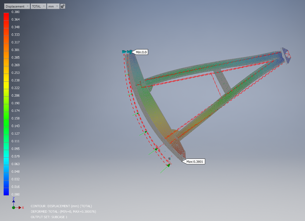

Hi Everyone,
I am running a FE analysis of a structure, the shell part where the load is applied on, shows zero stress. Could anyone let me know what is the reason or what I am doing wrong?
Any comment is appreciated in advance. The shell and solid Von Mises results are presented in these photos.

Did you check the material properties of the shell idealization. Be sure not to use the Generic material property. The pictures shows a min / max value. Does the shell results maybe show a stress singularity on one node for example?

It is not so easy to give advise if I don’t understand your problem.
From the title of this post I thought that all shell results are zero. But I am right that there is only one node that has a zero value?
Also I don’t see a displacement value at the summary at the bottom of your results plots. Did you check the displacement results?
If it comes to stress note that by default we are looking at the average nodal results. Is your stress plot showing the average, the min, the max?
Roelof Feijen
If my post answers your question, please click the "Accept Solution" button. This helps everyone find answers more quickly!
Message 7 of 17
hi @Roelof.Feijen
The displacement is:
Stress distribution definition:
Thanks in advance,
Ali

Are you sure that the 0 stress is in the shell? From your title, you have solids and shell elements. If I remember correctly (I am answering from home and do not have access to the software), I think the minimum value of 0 is in the solid, not the shell element.
In other words, it is possible that In-CAD displays a value of 0 in all of the solids because the solids do not have a "shell stress". If you edit the contour plot, choose "Part View", and select only the shell parts, then the minimum marker will show the true minimum value in the displayed parts.

Hi @John_Holtz
I checked part view, but I don't know why I can not pick shells!!!. So that, I just used the probe to pick a node stress. The stress on shell element could be seen in the following snapshot which is almost 0:
