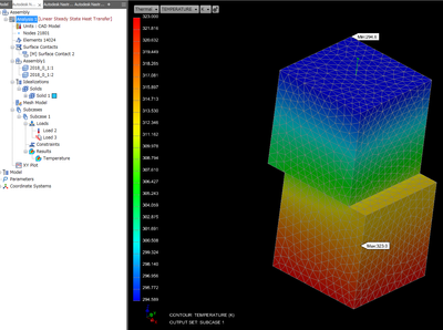

I have set up a simple model comprised of two cubes bonded together in Nastran In-CAD. Linear hear transfer analysis was setup up. The material used has thermal conductivity defined (see Fig.2). Heat it applied to the bottom of the lower cube and convection boundary condition is applied to the top of the upper cube. Bonded contact is used with a random value of CTC in BSCONP for demonstration purpose. Result is shown in Fig.3.

                                           Fig.3
