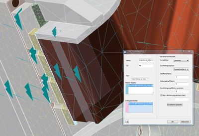

Hello everyone,
I'm currently performing a linear static analysis with preload. What I found out was that, in the second subcase, the separation contacts became bonded. Is this how the algorithm is written or have I made an error in setting up the contact.
Thanks for the help,
Prasanna
FEM model showing the contactsFEM model showing the contactsLinear static Analysis - Deformation of the body in red. Where it sepatates from the body in yellowLinear static Analysis - Deformation of the body in red. Where it sepatates from the body in yellowLinear Static Analysis with Preload. The body in red does not separate from the body in yellow even when the boundary conditions remain constant.Linear Static Analysis with Preload. The body in red does not separate from the body in yellow even when the boundary conditions remain constant.FEM Model with the Bolt in placeFEM Model with the Bolt in place

I assume the preload is coming from the bolt.
I just did a simple test with version 2020. Two parts, one bolt, separation contact between them, and two subcases. The parts were able to separate in both subcases. If you open the log file with Notepad, you should see lines that indicate the analysis is performing iterations during both subcases, such as this:
  • LINEAR CONTACT SOLUTION FOR SUBCASE 1 ITERATION 1
  • LINEAR CONTACT SOLUTION FOR SUBCASE 1 ITERATION 2
  • LINEAR CONTACT SOLUTION FOR SUBCASE 1 ITERATION M
  • LINEAR CONTACT SOLUTION FOR SUBCASE 2 ITERATION 1
  • LINEAR CONTACT SOLUTION FOR SUBCASE 2 ITERATION 2
  • LINEAR CONTACT SOLUTION FOR SUBCASE 2 ITERATION N
The iteration number will increase for the first subcase until it converges, and then it repeats for the second subcase.
Also, check to make sure there are no warnings such as "failed to converge". It could be that the second subcase did not get to the final result and is outputting an invalid solution. (Invalid as in some points are in tension instead of converging so that no points are in tension.)

Hi @shigeaki.k ,
thanks for the reply. Unfortunately last Thursday was a bank holiday here in Germany and hence we were off for the whole week.
I'm using Nastran In-CAD 2019 2.0.288
Autodesk Nastran 2019 13.2.0.168
I performed the linear static analysis with preload.
I gave the bolt details in the connectors part.
In the first subcase, I gave the boundary conditions such as the frictionless contacts and pin contacts.
In the second subcase, I used the same boundary conditions and to that, I gave an additional rotational speed.
I hope I've answered your question.

Sorry @Anonymous. I missed the fact that the analysis type is Prestress Static. I just did a test model using a prestress static analysis with a bolt and separation contact, and both subcases show that the separation contact was treated as bonded contact.
My suspicion is that prestress static does not handle separation contact, just like a direct transient analysis does not handle separation contact. (Faces with separation contact held together in a linear analysis in Nastran) I think that only "linear static" supports separation contact.
I will check with development to see if this is true.
