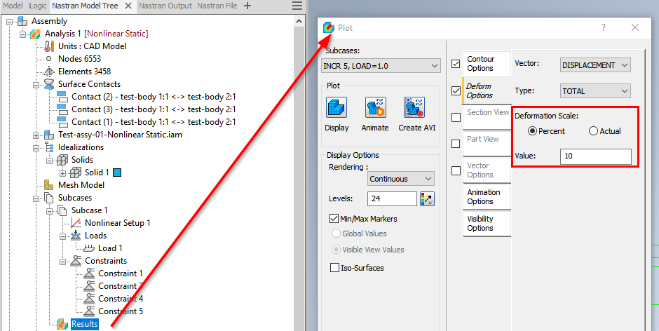

Message 9 of 24
Roelof.Feijen
Hello @Anonymous ,
That is because you have set the Deformation Scale not to actual, but to a certain percentage (10 by default).
2020-02-27 11_08_43-E__MyStackStorage_Trainingen_Nastran In-CAD_999_Research_Fatigue_01 Multi Axial .png
Based on that setting (percentage) deformations are scaled based on the largest dimension of the model.
That is why it looks like the part have penetrated.
This behavior is perfectly explained in this article on the Autodesk website. Have a look.
Roelof Feijen
If my post answers your question, please click the "Accept Solution" button. This helps everyone find answers more quickly!
