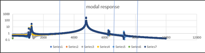

I`m testing the resonant frequencies of a body but seems like the code only produces force in the positive axis not full ac -1 0 1.... the thing is...
This is the graphics
I have for the simulation
but I was hopping for something like this....
Appreciate any replies...
Message 9 of 14
John_Holtz
Autodesk Support
Autodesk Support
Hi @maildodanillo
You are incorrect when you write "seems like the code only produces force in the positive axis not full ac -1 0 1". The analysis is for a load that follows an infinite sine curve: load = load magnitude*sine(forcing frequency*time+phase angle) where
  • load magnitude is entered in the model setup.
  • forcing frequency is entered in the Dynamic Setup
  • phase angle can be specified for the load.
Time is not entered because the analysis is not calculating results versus time. Only the results from the peak is output, and therefore it does not matter if the value is "positive" or "negative". The model vibrates equally in both directions. In other words, X*load magnitude*sine(90) = -X*load magnitude*sine(270), so why output both +X*load magnitude and -X*load magnitude?
It looks like you have copied the data from the Nastran results to Excel, so you should be able to create the graph that you want.

Message 10 of 14
maildodanillo
Hi John thanks for the fast reply.
So I got to print this result in "-X*load magnitude*sine(270)" and add to this actual graph?
I`ll try that, but my main question is just for one second to consider that +x, 0, -x.
Could it be used than as a two degrees of freedom system?
As two +x, 0 equations, doesn't sound correct in the math point of view.
Something going back in the negative convergence to same value as inertia and stress.
I wonder that the graph should have some x^3 for answer or something like it.
changing energy and displacement in between +x and -x.
Am I that wrong?
Message 11 of 14
John_Holtz
Autodesk Support
Autodesk Support
Sorry @maildodanillo
Maybe I do not understand what you are trying to do.
  • I thought you have results for X values of 0 to 10000 and Y values that you have plotted. (Where these results come from is technically not important, but since you responded to an existing post about the analysis type names Frequency Response, I assumed that you are running a Frequency Response Analysis.)
  • Since the graph only has Y values that are positive and you want to add plots are are negative Y values, all you need to do is add another column (or 5 or 20 or how many plots you want to add) to your spreadsheet and enter the formula -1*Y. That would give the "mirror image" that you show in your mocked-up image.
Let us know if you are asking about something different and/or a different type of analysis.

maildodanillo
Hi I just wanted to have if possible a suggestion why this is happening...
Below is my simulation with ANSYS, and it seems a bit diferrent.
This is almost the same simulation with NASTRAN, shapes are very close but frequency is very off around 10khz.
Message 14 of 14
John_Holtz
Autodesk Support
Autodesk Support
Hi @maildodanillo
Frequencies are related to the stiffness and the mass. If the frequencies are different, you should check the material properties (modulus of Elasticity for stiffness and mass density for mass) and constraints (for stiffness of the model). Until you resolve the differences in the frequencies, there is no need to run a Frequency Response analysis.
The first graph looks like a plot of random numbers. It does not look like the result of a frequency response analysis. The other two graphs look like a frequency response analysis where the peaks at resonance are clearly defined.
