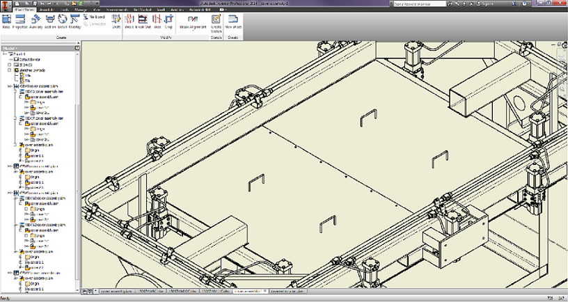

I'm working on an assembly that has some polycarbonate sheet as a cover. I'd like it if I could see what is behind the clear material in my drawing.
This is very different than wanting hidden lines - I do NOT want to see every hidden line of the parts behind the transparent material. I only want to see the next visible part, maybe as a lighter line, but only the visible edges.
It would be great if there was an option when you right click a part to set as transparent in the drawing - similar to toggling visibility or hidden lines.

@mrattray - Turning the visibility off will make the edges of this part disappear. I still want to see the outline of it. @Dan.M - Our company plotter does not like the shaded views - everything is very dark with shading. I avoid shaded views when possible.
