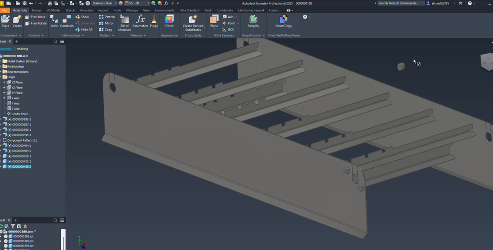

Hello Autodesk,
Please explain why the symetric mate shows fully constrained and how I can still move it even though there is a white dot and a general prohibition sign that shows up.
Since I'm posting on the ideas forum, I think this should all be one operation in the miorr comand. I've seen many autodesk forum posts and other people complaining about this for quite a while and nothing has been done.

tstout9GFVP
Watching your video clip, it looks like you are attempting to create a symmetric constraint between opposite faces of the same .ipt file and a center datum plane. Inventor has never allowed this, even though it is highly needed and has been requested as an improvement idea on this forum. The only way Inventor will allow symmetric assembly constraints is if the two faces desired to be symmetric belong to distinctly different .ipt component files.

@tstout9GFVP
Yeah since it only works between different parts, I'm making what seems to be like 1,000s of work planes which is time consuming.
