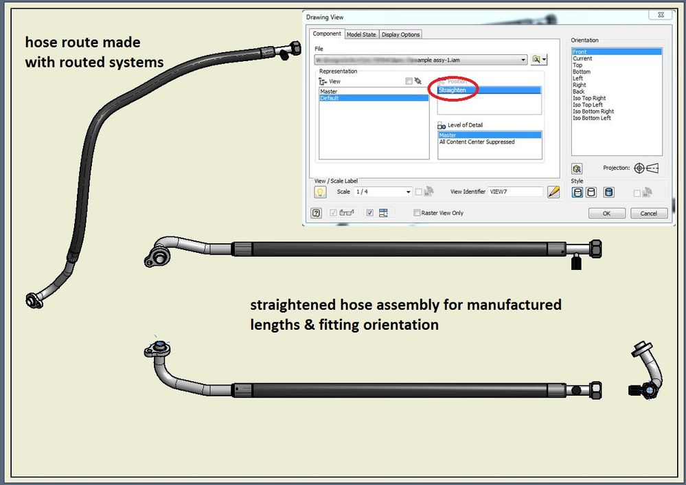

I use routed systems on a daily basis, 80% of the time I use bent tube routes, these are then CNC bent using the YBC data that is easily exported. Hose routes are a different story. it would be great to have a straighten option in the view placement dialogue box, true hose length and the offset of any elbow fittings or porting can be properly documented.
