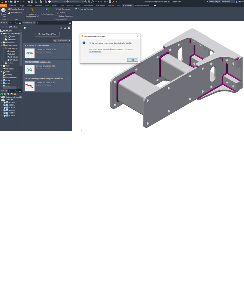

So, tried it in INV 2022...still can't. Tells you to exit environment, but when you switch to the Weld environment, there's no way of turning it off once you commit.
This needs to be fixed so we can do Shared Views from weld environment!!!!
