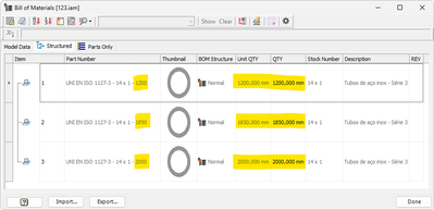

The issue is that we use this function in many custom iParts in a large assembly, and many of these suppressed iParts are showing in the BOM, even though the BOM is set to "hide suppressed components" (Inventor 2024.2). I believe this is happening because of the BOM structure.
I was able to "isolate the problem" in a small assembly to demonstrate the behavior:
I created an assembly named 123.iam, and then I created two more parts (456.ipt and 789.ipt), both with the same part number "ADSK." However, in the properties, there are different texts mapped to keywords (iProperty).
  • 456.ipt | PARTNUMBER = ADSK | Keyword = 456
  • 789.ipt | PARTNUMBER = ADSK | Keyword = 789
To replicate the issue, let's say you want to suppress the 456.ipt item and leave only the 789.ipt item active. In the bill of materials, it will display only one active item. However, the keyword field, instead of displaying 789, is shown as VARIES. I understand that if the part is suppressed, the keyword field should not appear as VARIES, but rather as the corresponding active item, in this example: "789."
In this particular case, the suppressed part doesn't show in the BOM, but because the suppressed iPart BOM structure continues as "normal" instead of "reference," the keywords appear as "varies." If I manually unsuppress the custom iPart, change its BOM structure to reference, then suppress the part again, the iProperty of the active iPart is shown perfectly in the BOM.
