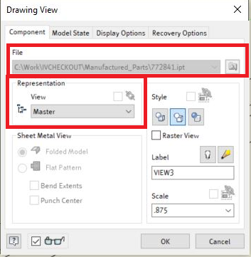

jason-dave.baker
Being able to change the file path and Representation View for any file type including .ipn of any individual drawing view would be a great add-on in the "Edit View" window. That way you could either Replace the Model Reference in the manage toolbar or individually change the link for a specific View.
Why aren't these boxes available to change in a Drawing file? Why can't we change an ipn View in this window?
When we create the view, we have access to all the views. this should not be locked once the view is created but remain available to change if we need to.
