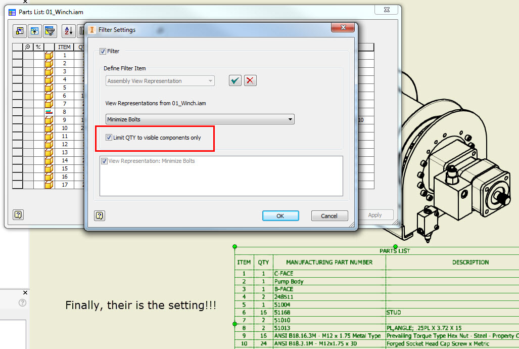

Within Autodesk Inventor 2017 you can now use visibility QTY within the partslist.

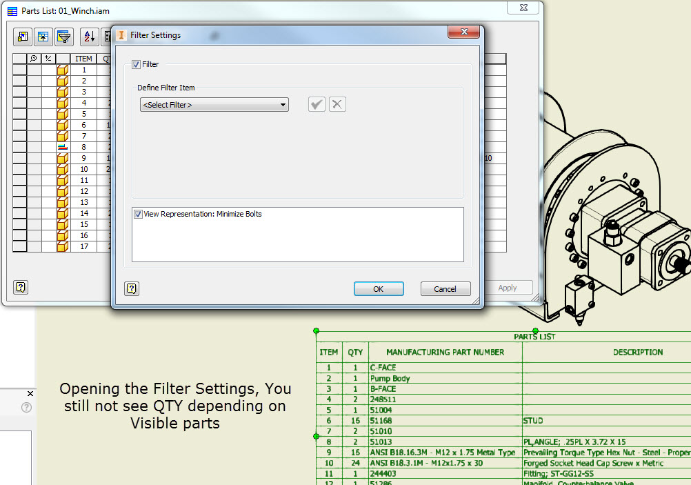

I don't know when or why you want to use that, but theirs one thing I'm more consurn of and that is you can't see that you have used a Filter for QTY depending on a view representation.
Opening the Parts List, you don't see the use of View representation incl. QTY of Visible Parts.
Opening the Filter Settings, you see the use of a View Representation, but not the use of the QTY depending on visible parts.
After Editing the View Representation you finally see the setting.
This is not accepted!!!!
Make a recognized image in the browser or something.
