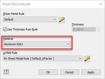

I recently came across this with a customer. Where they are using Multi Body Sheet Metal for large fabrications. After using Make Components, with link sheet metal style turned on, to pick up thickness changes etc. Some of the derived parts need different materials, so the Material is changed from "By Sheet Metal Rule" to whatever is required, example below.
However, if a change is then made to the master part, for example a cut or a hole is added to the part with a changed material. After updating through the models, the derived part Material reverts back to "By Sheet Metal Rule". If this is not noticed, there is a risk that Parts Lists or BOM's are wrong.
