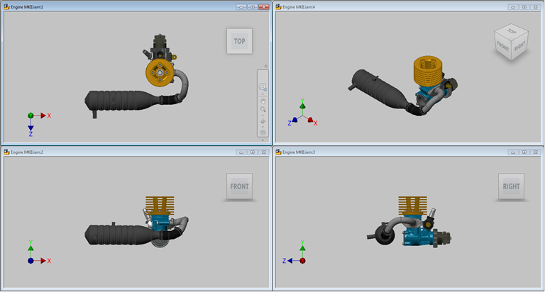

Similar to Maya's panel views, it would be nice to see multiple axes being viewed simultaneously in the same window. Changing things in one view would of course affect the other views simultaneously. In my opinion, this would vastly improve part placement during assembly, and would also make 3D sketches easier. See below for mockup.

It is possible to get 4 views of a model, but I feel there are too many steps as compared to 3ds Max, AutoCAD, etc. The challenge is that 3ds Max can only have one model open at a time as compared to Inventor.
Try these steps to acheive a 4-view.
  1. Open model (IPT, IAM, or IPN).
  2. Select View Tab > Windows Panel > New.
  3. Repeat this twice more to get four windows.
  4. Select the Tile All button on the ribbon or the Arrange button in lower left area of graphics window.
  5. Select each window in turn to set the view (Top, Front, Right, ISO)
Close extra windows to reduce back to a single window. Granted, not as easy as AutoCAD, but a model multiple view can be acheived.

Click NEW 3 times, then hit TILE ALL, and set your views however you want.
That said, I'm curious as to why you need to use multiple views like this to control your 3D sketches.  99.999% of the time, your 2D sketches are providing the definitions that your 3D sketches will use to create their geometry.
Good tip!
However, there's some strange behavior. Pre-highlighting works in all windows at once, but when something is dragged in one window, it only updates on mouseup. It would be useful if it updated in real time. Still, thanks for the tip. This is rather helpful, especially for large assemblies. I only showed an .ipt above because it was easy to throw together.

You can already do this, (to a certain degree). After you open your part/assembly, go to the View tab & use the "New" command to create 3 more views. Then use "Tile All" to arrange the views. Each view can be oriented as desired & you can work across views, when modeling.
Thank you Chris for responding. Although the functionality is similar, the workflow is not. If I already have more than one file open, this solution doesn't work. Yes, it's trivial to close and re-open files, but if I'm working in an assembly, chances are I am bouncing between other part files too. This interruption would get more annoying with each repetition.
And if I only have the cloned views open, moving items in one view does not update in other views until the click+drag is released. This is also cumbersome. It would be very useful if there was a way we can get multiple views in a single assembly window, and live-update when a part is click+dragged. Should I re-submit this suggestion as a clarification? Thank you.
